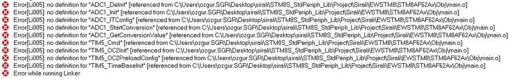

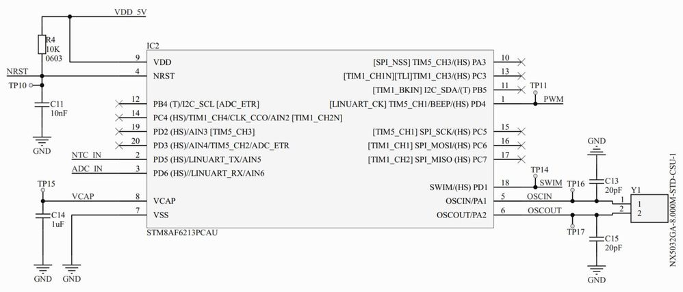

I am using STM8AF6213 MCU in my project. I am using PD6 (AIN6) pin to read analog value. I use PD4 (TIM5_CH1) to generate PWM. But the stm8_adc1.h and stm8_tim5.h libraries that I included in my project do not work properly. It does not see the functions in the library.
#include <stm8s.h>
#include <stm8s_gpio.h>
#include <stm8s_conf.h>
#include <stm8s_tim5.h>
#include <stm8s_clk.h>
#include <stm8s_adc1.h>
uint16_t CCR1_Val1 = 5533;
uint16_t CCR1_Val2 = 4800;
uint16_t CCR1_Val3 = 4000;
static void TIM5_Config1(void);
static void TIM5_Config2(void);
static void TIM5_Config3(void);
uint16_t Conversion_Value = 0;
static void ADC_Config(void);
static void GPIO_Config(void);
void main(void)
  CLK_DeInit();
  CLK_HSECmd(DISABLE);
  CLK_LSICmd(DISABLE);
  CLK_HSICmd(ENABLE);
  while(CLK_GetFlagStatus(CLK_FLAG_HSIRDY)==0);
  CLK_ClockSwitchCmd(ENABLE);
  CLK_HSIPrescalerConfig(CLK_PRESCALER_HSIDIV1);
  CLK_SYSCLKConfig(CLK_PRESCALER_CPUDIV1);
  GPIO_Init(GPIOC,GPIO_PIN_4,GPIO_MODE_OUT_PP_LOW_FAST);
  CLK_CCOConfig(CLK_OUTPUT_CPU);
  CLK_CCOCmd(ENABLE);
  GPIO_Init(GPIOD, GPIO_PIN_6, GPIO_MODE_IN_FL_NO_IT);
  ADC1_DeInit();
  ADC1_Init(ADC1_CONVERSIONMODE_SINGLE, ADC1_CHANNEL_6, ADC1_PRESSEL_FCPU_D2, \
  ADC1_EXTTRIG_TIM, DISABLE, ADC1_ALIGN_RIGHT, ADC1_SCHMITTTRIG_CHANNEL8,\
  DISABLE);
  ADC1_ITConfig(ENABLE,DISABLE);
  ADC1_StartConversion();
  GPIO_Init(GPIOC, GPIO_PIN_3, GPIO_MODE_OUT_PP_LOW_FAST);
  Conversion_Value=ADC1_GetConversionValue();
  if(Conversion_Value <= 400 &&  0 <= Conversion_Value)
  TIM5_Config1();
  while (1){
  else if(Conversion_Value < 800 &&  400<= Conversion_Value)
  TIM5_Config2();
  while (1){
  else if(Conversion_Value < 1024 && 800<= Conversion_Value)
  TIM5_Config3();
  while (1){
  else{
  TIM5_Config2();
  while (1){
