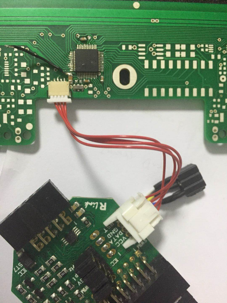

Posted on May 02, 2018 at 12:43
Hi Tim,
Thank for the reply.
Yes VDD and VDDIOs are connected, VSS and VSSIOs as well. There is also a external capacitors VCAP-VSS which is 1uF.
Below, you can see how I connect to flash the code; The PCB contains only the condos for the VDDs et VSSs, NRST pin and for VCAP.
(Don't care about the black wire, it is not connected)
Do you have any suggestion about this connection?
Best regards,
YE David

Posted on June 08, 2018 at 06:11
Hello Laurent,
We finally resolved the problem thanks to your comment.
All came from one misunderstanding. The Vcap was present on the electrical schematic design but not in our SMT machine programming files.
The flashing is working properly either with Raisonnance Rlink or with STVP RT-link.
Many thanks and best regards,
