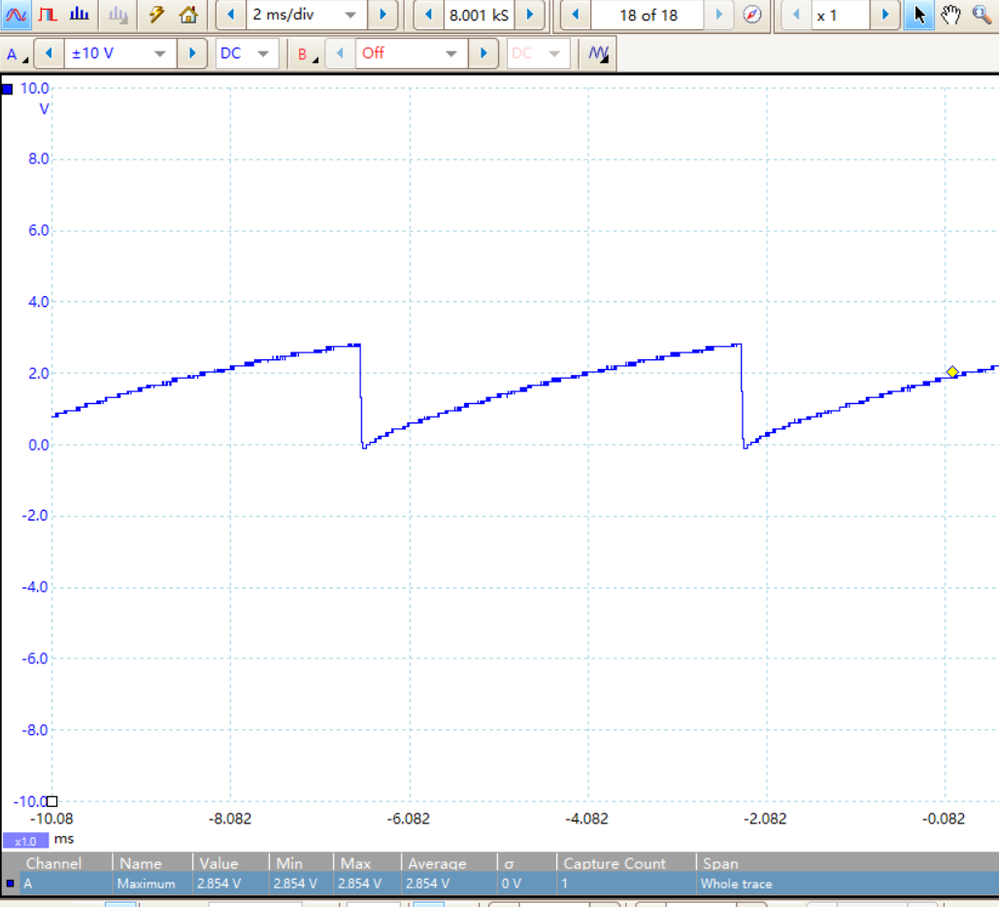

There is only a condensator connected to this pin during my test :
But you can see that the signal NRST(shown below) is not pulled up as it should be :
If I remove the condensator, I have this on the NRST pin :
Please can someone tell me why I have this signal in the NRST pin while there is nothing going on? In my undersanding I should have 5V straight while nothing is happening; So where this signal comes from?

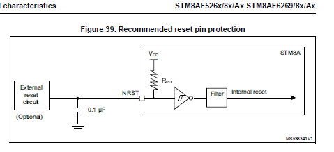

The datasheet specify the pull-up for around 40kOhm (see 10.3.7 Reset pin characteristics).
With the capacitor on the pin, we have a RC charge with a time constant of around 40kOhm x 10nF = 400us .
Am I wrong or this seems quite in line with the waveform you are observing?

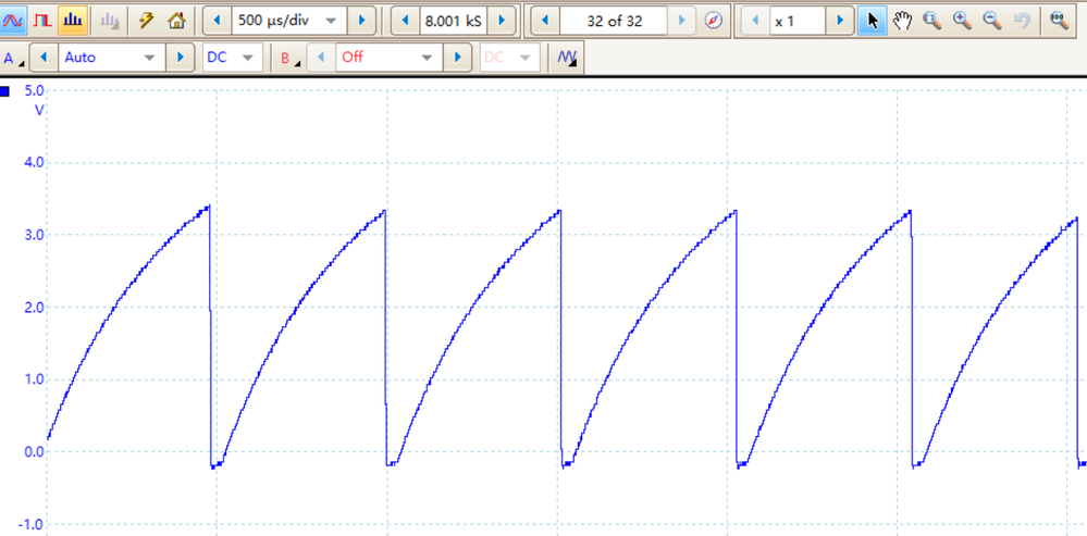

Indeed, the signal that we are observing correpond to the constant time for 10nF.

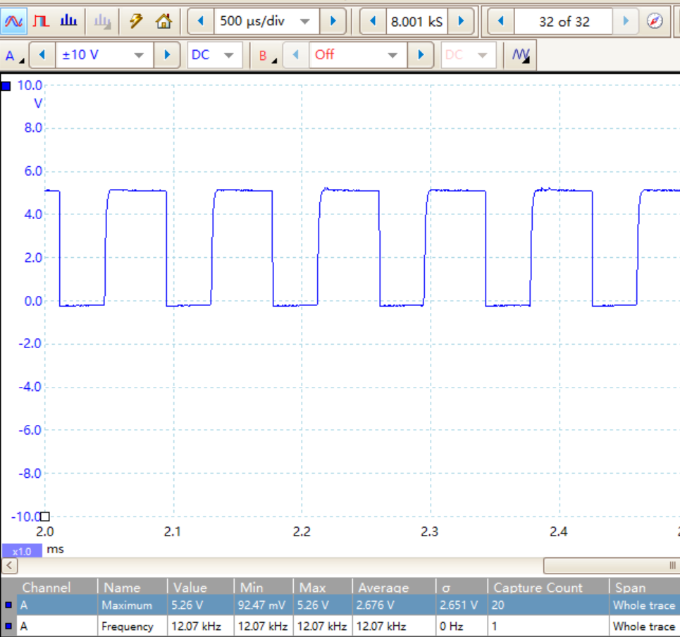

Nevertheless, the ''square signal'' is the source of the problem and in my understanding, changing the condo will not solve this problem. Here is the signal when we have 100nF condensator :
Normally, this NRST pin should always be at VDD,so 5v (when nothing is happening). I do not understand why there is a square signal instead. Is it trying to restart over and over?
To my understanding, having this square signal means that uC is constantly restarting; then flashing program is impossible.
Also, I do not think that the problem comes from the GPIO configuration because the code that I am trying to flash is empty !
Thank you in advance,
Regards,
Ye David

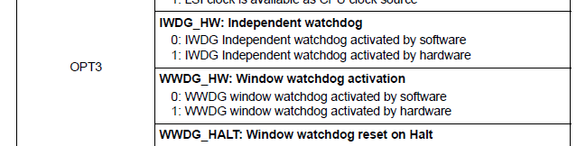

This seems a bit fast but it could also be coming from the watchdog...
Select the software watchdog mode in the option byte to confirm.
In hardware mode, you must service it in your code to avoid a reset.

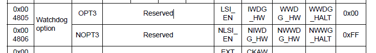

As I never succed in flashing a code and seeing that reset value of the option byte of the IWDG_HW is 0, I assume that the uC is already in software watchdog mode.

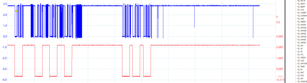

For information, this is the signal that I have when I am flashing a program with the stm8AL31 of one another board (SWIM in blue, NRST in red):
This problem seems to be very hard to solve, is there a possibility to be in contact with a STMicroelectronics developper of this uC? It has an important purpose for our company.

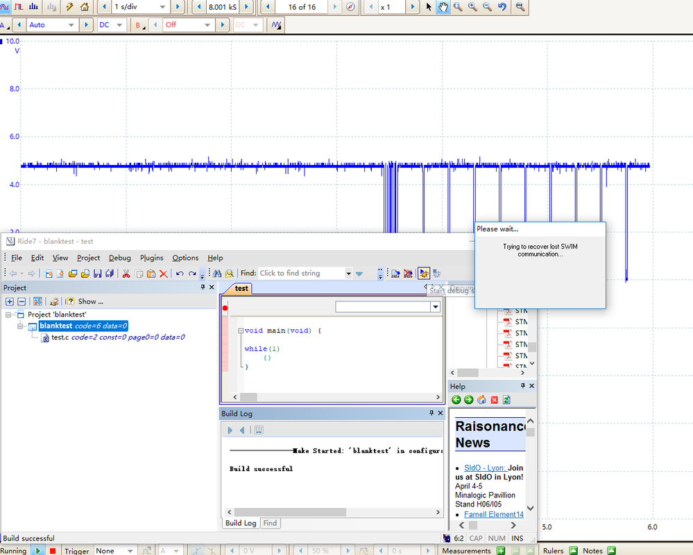

This is the signal when the STlink tries to retablish the SWIM communication.
and the NRST pin at the same time/division0690X0000060AaIQAU.png
What do you mean by bricked chip? I already changed three time the chip and have the same results.
Do you know another way to force the chip to be flashed? Is this problem occurs lots of time?

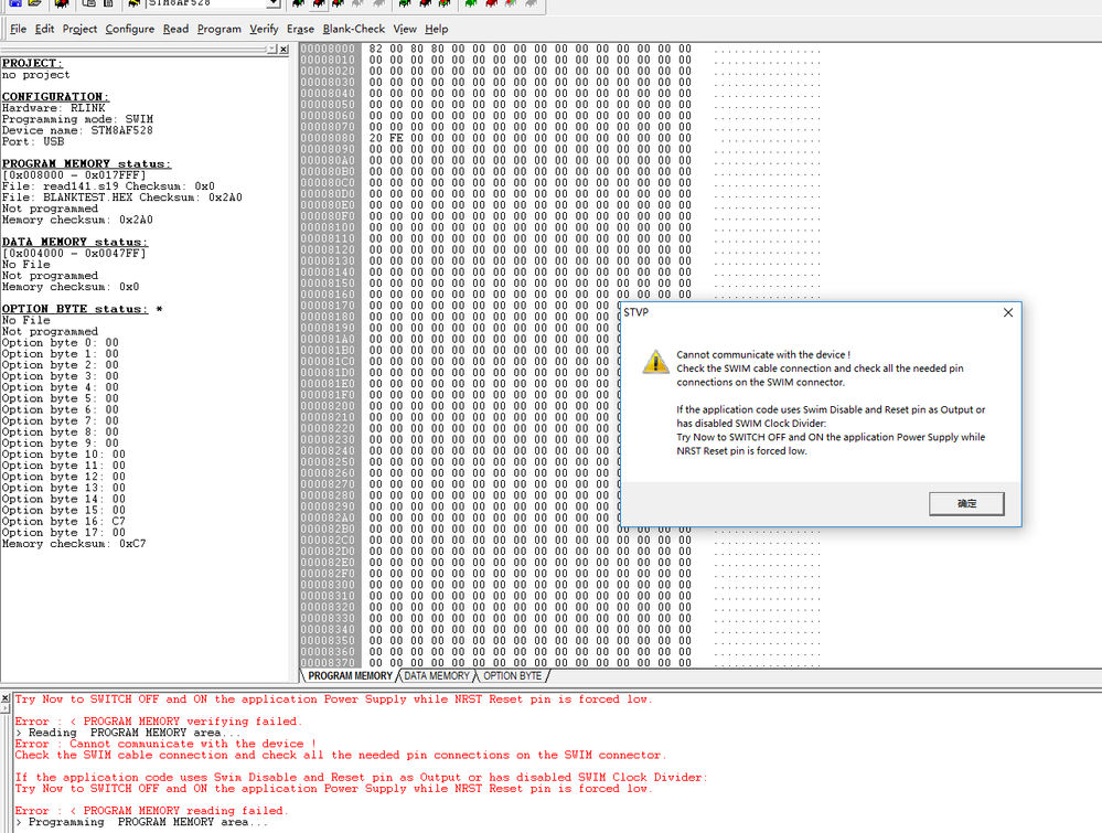

I downloaded the STVP and used the HEX file to flash the program.

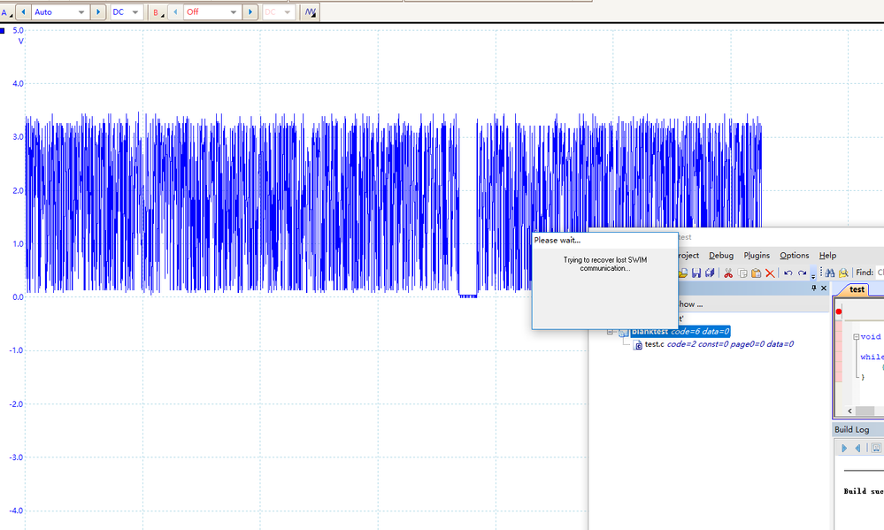

Unfortunately, same problem occurs. The communication with the device is not possible :
The problem is that the Microchip is constantly toggling the NRST pin (screenshot are in the original post).
How can it be possible to still have this same issue knowing that I prepared the most simple circuit and with differents chip.
I am really looking forward to find the solution.
