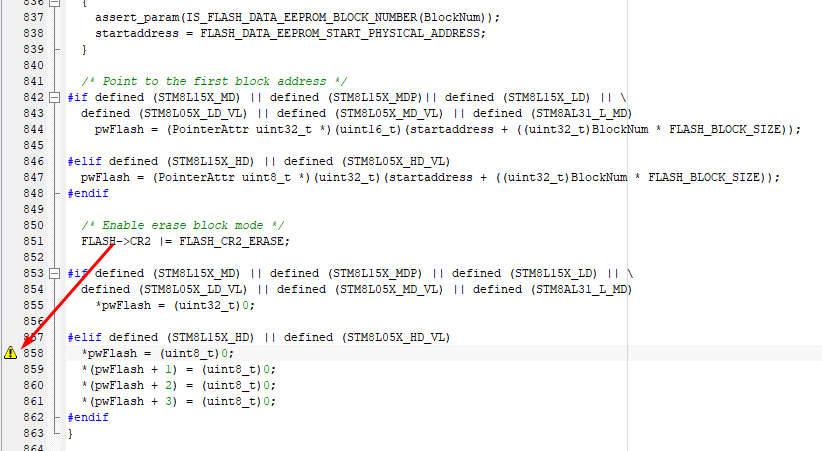

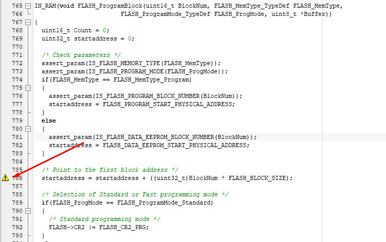

The problem is I am getting a compiler warnings:
Also, I get the program hangs in the FLASH_EraseBlock() function on line 858.

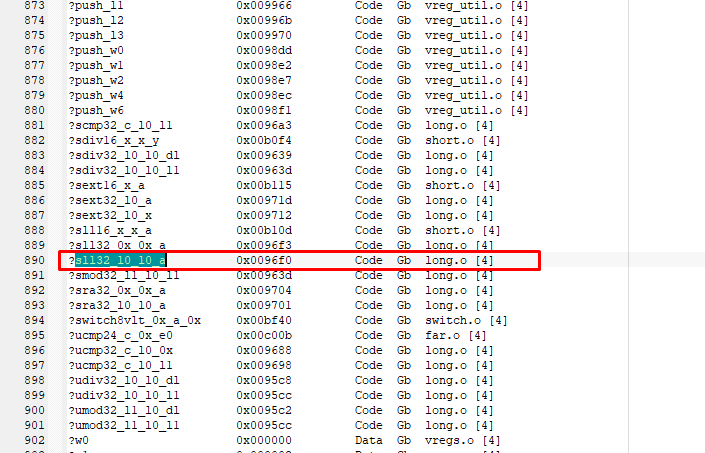

I assume that the freezes and warnings are due to the fact that the instructions add32_l0_l0_l1 and sll32_l0_l0_a are in flash memory.
But what can I do? How do I get rid of the warnings and get block write and erase to work correctly?
