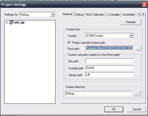

All that I have done is opened up the My Workspace.stw file in STVD and pressed build (F7) It appears something is not setup correctly here... any idea's what could be causing such an error...2010-04-29 5:03 AM
I've change the compiler path to fit with my environement.
you need to change the compiler path in project>settings
2010-04-29 5:16 AM
I've changed the settings file to match what I have...
Still getting an error message...2010-04-29 5:35 AM
