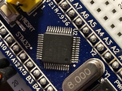

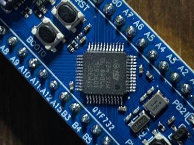

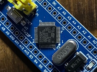

The board has passed a authentication test so I currently believe it is a me issue.
I have been trying to get a CAN bus going using the STM32 Blue Pill board with a TJA1050 CAN Transceiver, but for some reason even with basically copy pasted example code I don't even get activity on the lines. The transceiver modules I am using has the CAN bus terminating resistors built in resulting in a 60ohm resistance between the H and L lines. I've ended up putting together a basic test Tx and Rx bread board in hopes of figuring out whats going on with no clues. The Tx loop eventually goes dead for some reason which makes me think the HAL_addTx started locking up. Linked is a github repository with both projects. Also a video of the boards.
2025-10-15 4:33 PM
Loopback has worked on at least one board type before. As soon as go into debug mode it runs what seems like half a loop and dies. I got the HiLetGo boards and they do the same. Can I get someone else to test the project on a known genuine board too. I should be getting CANTx data with just the board nothing else but I don't get anything on now 4 board variants. I think I am going to order genuine chips and swap them in. Maybe bluepill diagnostics just made fakes better. I have tried multiple code projects, boards, connections, data analyzer/scopes. I think I am getting nothing but non genuine boards.
2025-10-15 5:27 PM - edited 2025-10-15 5:29 PM
Just added Loopback to the Tx Test on GitHub and they seem to be failing. The peripheral is manually set to loopback with mx. There only is one chip that visually seems distinctly authentic. On the HiLetGo board but still it didn’t pass anything. Also in programmer they all show up the same 0x410 and Version X which isn't marked on any chip.

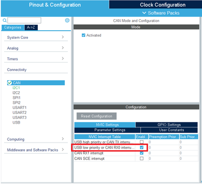

For the loopback to work and capture the sent message, you have to turn on the CAN RX0 Interrupt:
Your latest GitHub code works for me, on my Blue Pill after selecting the interrupt. A message is sent and my breakpoint inside the HAL_CAN_RxFifo0MsgPendingCallback() is hit.

After turning on the interrupt they pass the loop back test. Were you able to run it in normal and get can data being transmitted? My pins are wired accordingly. PA11 to TJA Rx, PA12 to TJA Tx, GND to TJA GND, 5v to TJA VCC. I believe I should be able to run a scope or analyzer and see a change in flow even before a nack can occur, with nothing attached while probing PA11 and PA12.
