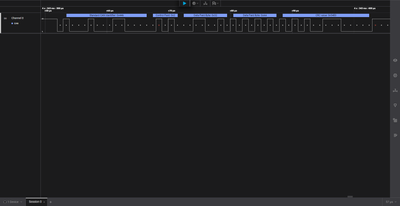

I tried your CAN Tx Test and it seems to be working fine:
I don't think I made any changes, but I attached the project to this message. Note that I don't have anything connected to the STM32F103C8T6 except for the TJA1050. I don't even have a 120 Ohm resistor. I just have the output of the TJA1050 connected directly to the logic analyzer. I would start there, remove everything and make sure the logic analyzer is showing the data being sent, at least then you know the data is being put out on the wire.

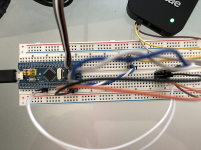

I don't know how much it matters but are your wires twisted together for the CAN wires? I have very loosely twisted wires from the TJA1050 to the logic analyzer, maybe it shows up in the photo.
Doesn't make sense why it works for me with the exact same setup. Have you stepped into the code to see where it might be failing?

Sure, I'm using STM32CubeIDE v1.19.0 and one of those cheap ST-Link devices I got off Amazon, I have the genuine ST-Link but used the Amazon one for testing your project. I'm using the Blue Pill listed above at the Amazon link. I also purchased the TJA1050 from Amazon (Comimark TJA1050). I used all of your settings and connected the +5V and GND to the TJA1050. I connected PA11 -> TJA1050 (RX) and PA12 -> TJA1050 (TX). I then connected the TJA1050 CanH and CanL to the logic analyzer. That was all I did.
Maybe the TX and RX are connected backwards like for UART? I didn't try that, I have RX->RX and TX->TX.
