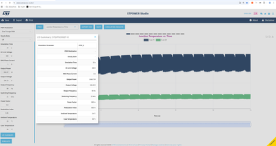

I am attempting to use STPOWER Studio to run a thermal simulation but every time I start a simulation it just sits at 0% complete, showing Simulation in progress: iteration counter [ 0 / 63]. Has anyone run into this problem?  Any suggestions on what might be the issue?
This is my configuration:
I/O Summary: STGIPNS3H60T-H
Simulation Parameter STEP_0
PWM Modulation
Steady State
Simulation Time
15 s
DC Link Voltage
300 V
RMS Phase Current
1 A
Output Power
216.37 W
Output Voltage
156.15 V
Output Frequency
60 Hz
Switching Frequency
21 kHz
Power Factor
800 m
Modulation Index
850 m
Ambient Temperature
25 °C

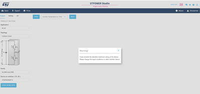

Carmelo VICCICA
Hi Phil,
The engineers have solved the issue.
Now, in production, there is a new backend version, BE 6.1.1.
For your project, the engine sends an error message regarding the Tcase temperature.
It is necessary to decrease the current to 0.35A to obtain a result.
In the attachment, you can find the updated project.
Regards,
Carmelo
