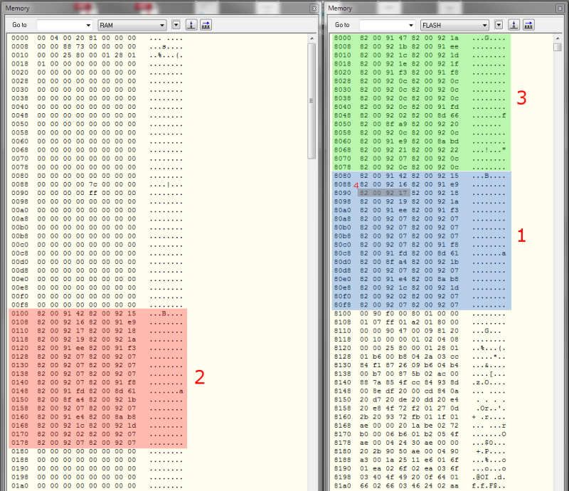

Hi All,
I am during writing bootloader for STLUX processor (base on STM8). Both, bootloader and main program uses own interrupt vector table. The STM8 processor has fixed interrupt vector table at 0x8000 address. I want to redirect from fixed vector table to vector table storing in RAM. I wrote the code to copy vector table from bootloader or main program to RAM and it is work fine, but I have problem with redirection. I do not know how can I do this. I use an IAR. I did an initialization a fixed vector table like this:typedef

The result:
As You see, The vector table from bootloader and ram is identical, so it is ok, but the values in fixed vector table are incorrect. I do not know why :(
Any idea? Update: When I manually set fixed vector table (0x8000 to 0x8080) to 0x00 (clear it, green color in above image) I see it is not programming by IDE (all bytes in section are still zero). Of course, I still uses a code attached above. *icf file://///////////////////////////////////////////////////////////////
