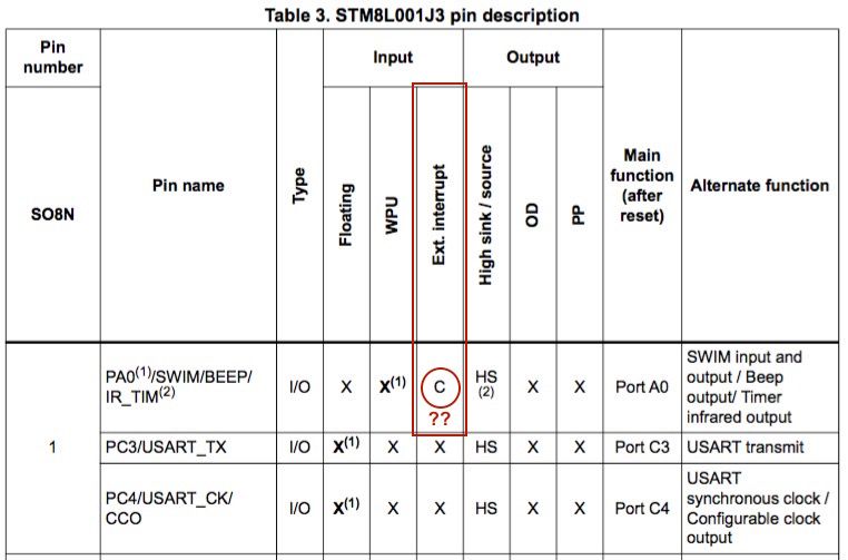

I will swap the LED command to PC2 I/O, removing MOS-N, R13 and connect P4 button on PA0/SWIM.But, since I must use this input in Ext Interrupt mode, I've noticed that this pin have a ''C'' label on this function (see Table 3 image).What's the meaning of ''C''? In Table2 of the D.S., I not found any explanation for this and then I'm not shure that I can use the I/O in ext interrupt mode.What do you think about?2018-05-19 4:22 AM
Probably a typo. 'C' is next to 'X' on the keyboard...

2018-05-19 5:43 AM
May Be... I hope.
In any case, I will test using STM8L Discovery board removing SB16 to exclude &sharpReset and to simulate STM8L001J3M3 hardware condition.We’re moving the ST Community to a new platform to give you a better and more reliable community experience.
