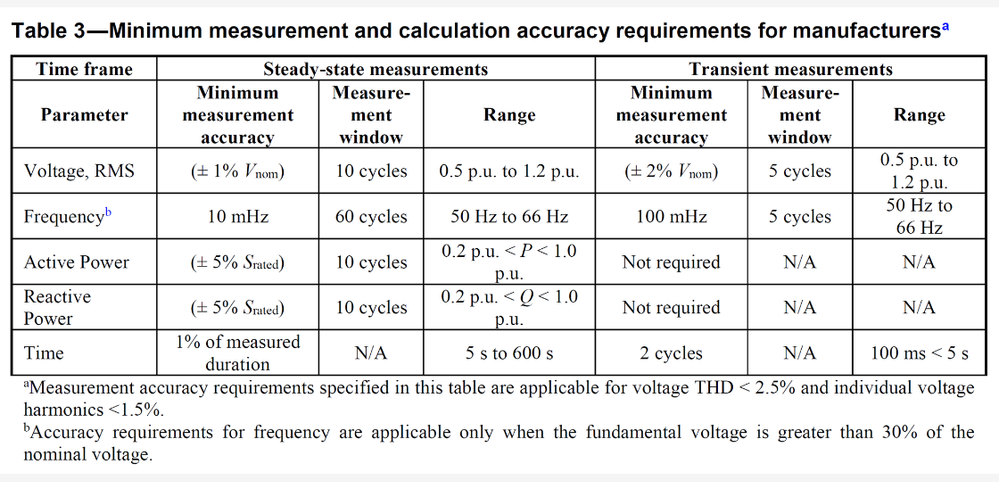

I'm working on a single-phase Panel meter. Which provides import and export of both energy sources on Modbus
For metering purposes, we are considering the STPM3x family of ICs (STPM32, STPM33, STPM34).
I've attached one image from which we expect accuracy from the STPM3x metering IC.
I have some questions about the metering IC which I mentioned.
If this IC is not suitable as per our requirement so kindly suggest another metering IC.
