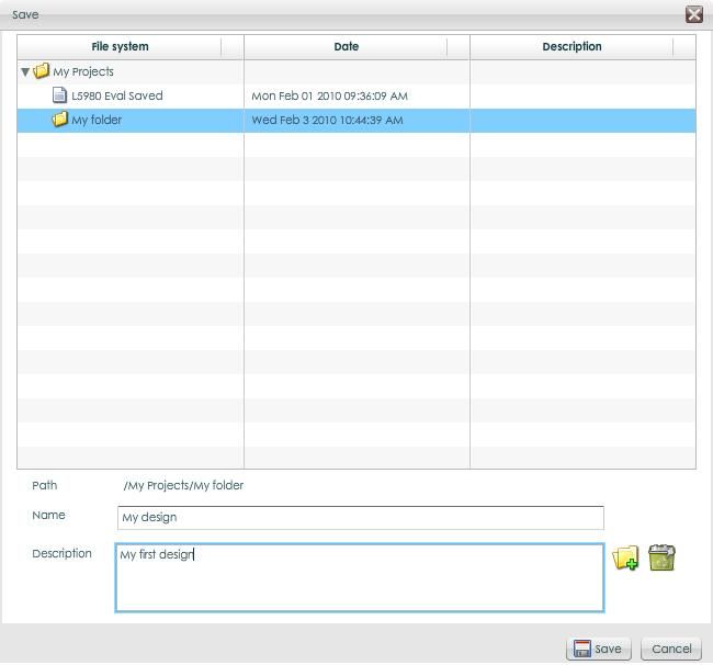

I created a design, and now I want to save it, in order to have it available again and not to recreate it from scratch. How can I save my project? Where will it be stored?
#edesignstudio2010-02-03 1:46 AM
You can save your projects using two different ways: export on file system, as a local file with prj extension, or save on server, so that you can open them on any machine, because your projects will be always available in My Projects folder. Moreover, you can organize your designs creating directories and giving them an ordered structure.
When you save a project, you have the possibility to specify a short description, that will be visible in Open dialog, so that you can better identify what you saved.2010-02-04 11:53 PM
