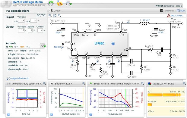

eDesignStudio simplifies power supply design and offers to designers the flexibility to choose the right products and topologies.
A full design is generated from the high-level requirements specified by user and provides:2010-05-28 11:09 PM

If you try to select a higher value for Vin-min (Example 12.1), you will get the some solution.
So: Vin 12.1-24Vdc to 12Vdc Vout, 1A conversion could be a better specification.
The Problem is that to get 12Vin to 12Vout conversion requires a buck converter with 100% DutyCycle and at the moment this tool doesn't provide solutions like that.
