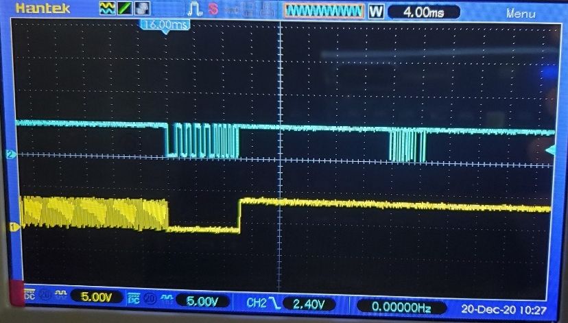

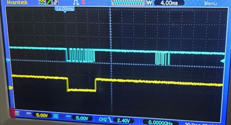

Error 1:
<NRST just going to ST Link OR NRST pulled up to VDD regardless of Pull Up value>
Error: Problem while trying to Reset swim and device. Apply a Power On Reset.
Blue = SWIM
Yellow = NRST

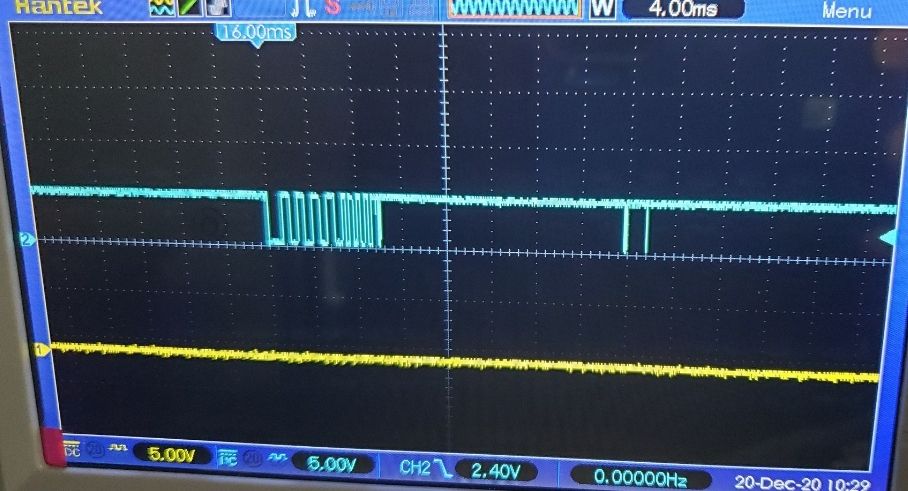

Error 2:
<NRST pulled to GND>
Error: Cannot communicate with the device !
Check the SWIM cable connection and check all the needed pin connections on the SWIM connector.
If the application code uses Swim Disable and Reset pin as Output or has disabled SWIM Clock Divider: Try Now to SWITCH OFF and ON the application Power Supply while NRST Reset pin is forced low.
If I follow the recommendation above, I just keep getting the same error.
I have not configured the pins as outputs. I have tried CLK_SWIMConfig(CLK_SWIMDIVIDER_2); and that did not seem to make a difference in results.
NRST pulled low: Blue = SWIM, Yellow = NRST
After I release the NRST pin and try again, the ~4.5KHz oscillation stops on the NRST pin, but still get Error 1 again.
