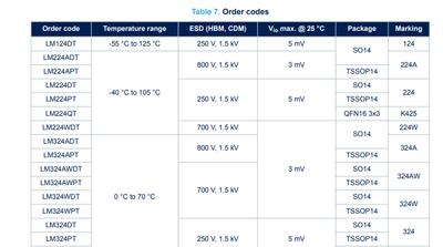

maybe 324 -> LM324
marking: 324 -> so with ST logo -> is : LM324DT

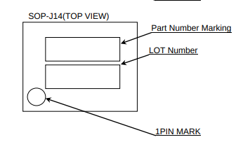

marking is a strange game ( for me, at least).
its whatever a manufacturer want to write...
EZG3745 is probably some cryptic code, for type and production /location/time - or
Some write useful simple and clear and explain in ds what it means, some like the "guess what" game.
You see...
here from ROHM LM324FV-GE2 ds :

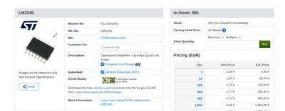

2025-02-15 11:01 AM
I would say you are right. I just googled "st 324 sop-14 smd photo" and I found an identical IC with a different bottom code. Thank you very much for your help.
