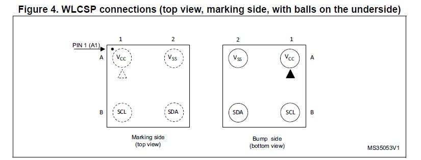

Trying to send an image but cannot.
Please email or call and I can send the image.
There are to many other images visible on the underside of the component (WLCSP) to confuse the vision system on the equipment. Even the equipment suppliers vision system expert could not program this component (M24C08-FCT6TP/T. Please Help!!
2020-05-14 1:00 AM
Could this figure help you ?
Let me know.
BR
Team EEPROM suPPort
2020-05-21 7:44 AM
Not at All!!! Zero Help!!
Please see image below.
Note all the other possible images that the vision system gets confused with.
Please call ASAP!!
2020-05-21 8:33 AM
Pretty sure they aren't going to change the package to suit your vision system, should work with you pick-n-place/vision system vendor to resolve, identifying balls and triangle, ignore die features and change lighting angle/contrast.
Work with your local sales office or FAE.
2020-05-27 8:20 AM
Thank you for the reply. The vendors Vision experts in Japan tried but could not process the image.
Thanks Again
