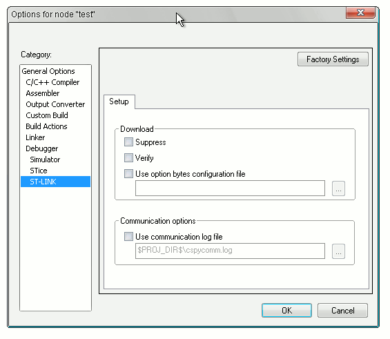

Does anybody know, how to program option bytes from IAR, during downloading flash image, like it implemented in STVP? Maybe, using some scripts to automate. I will need to program few hundreds of uCs, and setting those bytes every time manually will be boring a little bit :) #stm8 #option-bytes #iar2014-03-21 2:06 AM

Thank you, Pierre!
