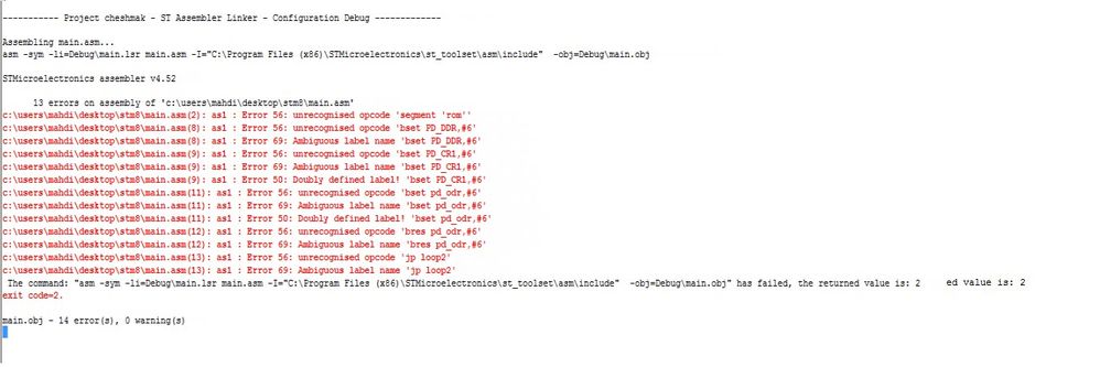

Hello. I want compile a simple program that is :
stm8/
segment 'rom'PD_ODR EQU $500FPD_DDR EQU $5011PD_CR1 EQU $5012;///////////////////////bset PD_DDR,#6
bset PD_CR1,#6loop2bset pd_odr,#6bres pd_odr,#6jp loop2end
when I compile this program Stvd get a lot of error that is :
can any one help me??
my windows is 7 and 64bit and I use from STVD and st assembler linker.
Thanks
2017-03-25 4:24 AM
You need to start your lines with spaces or tabs, otherwise the assembler assumes you're defining a label. Like so:
stm8/
segment 'rom'PD_ODR EQU $500FPD_DDR EQU $5011PD_CR1 EQU $5012;/////////////////////// bset PD_DDR,#6 bset PD_CR1,#6loop2 bset PD_ODR,#6 bres PD_ODR,#6 jp loop2 end2017-03-25 4:24 PM
