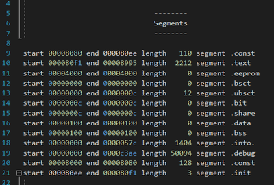

Yes, the linker generates a .map file. It is not particularly clear what these segments mean (see Figure 1 below)?

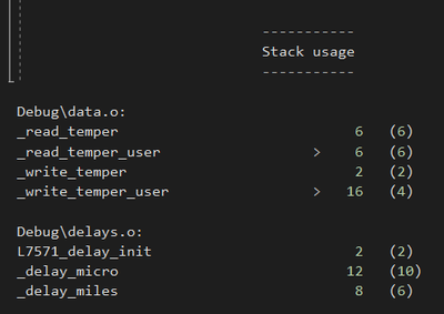

What do the numbers near the parentheses and in the parentheses mean? What do the arrows (>) next to some numbers mean (see Figure 2 bellow)?

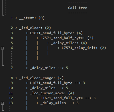

What do the arrows such (>) and such (-->) mean (see Figure 3 bellow)?
Is there information on this topic somewhere? I did not find it in the Cosmic compiler documentation.

For Stack I think numbers referred to auto/locals and then parameters
For Call Tree there's a top-level count of functions in brackets, and then probably some call/stack type impact
I'm not using STM8 parts, but contextually the importance should be relevant to someone who is.
For the Object file it's showing all the sections, the debug/info likely not contributing to data pushed into the device, but text/const
MAP files are the place to look for Linker output, you can also likely unpack the Object file directly with a suitable dump tool, or generate .HEX or .BIN you can import or view independently too.
