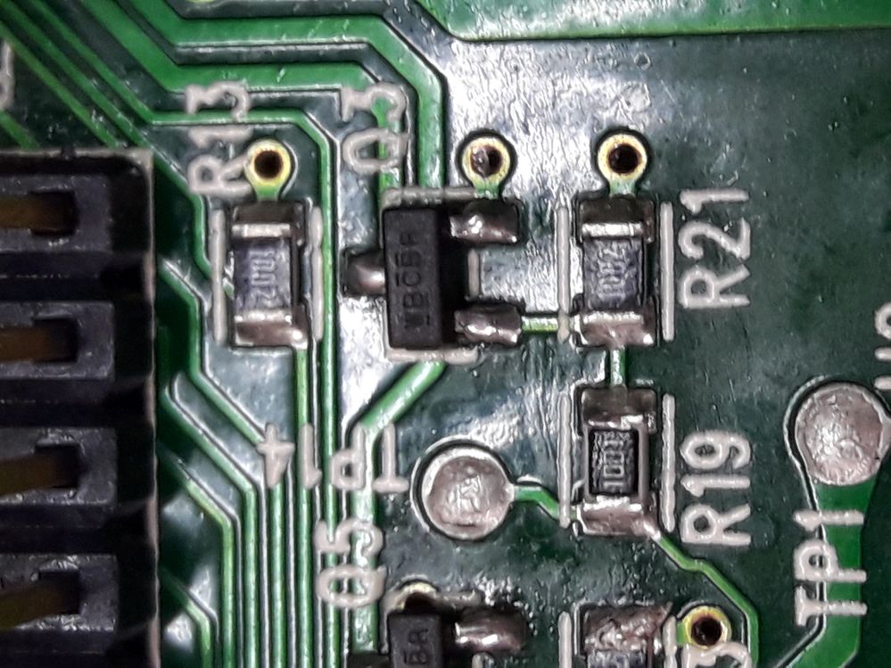

I have an SMD component, with the marking code WBCBR and it's a MOSFET, but I can't find the data sheet, can you help me?
2023-12-20 12:13 PM
Post a large, in focus, picture of the component.

Not sure, do you think it's an ST part?
ROHM 2SD1383K ? npn darlington comp
https://www.s-manuals.com/smd/wb
2023-12-22 8:27 AM - edited 2023-12-22 8:27 AM
I just ran through every tool we have here, and struck out. I also delivered that message to the requestor.
That one you showed looks darn close, main marking being the "WB".
My opinion, I agree this is not a normal naming/marking convention for an ST part and I would be willing to bet its not from ST. If it is (was), its decades old and no longer in our system.
