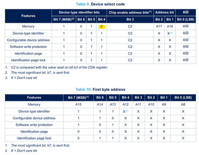

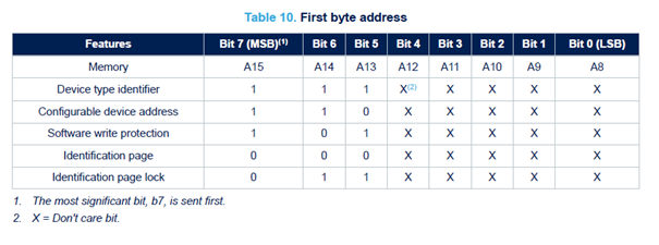

We wanted to replace an M24M01-DFCS6 memory (1 Mbit) with an M24M02E-F (advertised as 2 Mbit) available in a WLCSP5 package.
After starting the driver implementation, we realized that the sections “Device Type Identifier”, “Configurable Device Address”, “Software Write Protection”, and “Identification Page Lock” occupy more than 1 Mbit…
Is there actually a way to access the full 2 Mbit of this memory for data storage?
I feel like I've been misled...
Thanks
2025-09-05 6:27 AM - edited 2025-09-05 6:30 AM
Bit 4 = 0 selects memory. The others have bit 4 = 1.
A17=1 addresses the upper Mbit of memory.
2025-09-05 6:34 AM
Thank you !
I missed this information.
Have a nice day.
