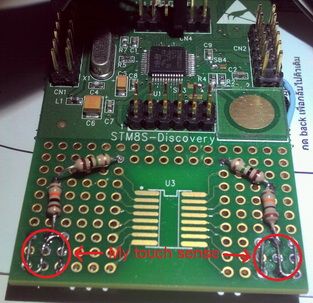

I recheck config on STM8S105C6.
My configuration some value wrong. Now it's work done. But on STM8S103K3 not work. in debugging sSCKeyInfo[key_number].state .whole = 8 '\b' .b all value is 0 only ERROR is 1. sSCKeyInfo[key_number].Channel .LastMeasure = 0 .Reference = 0 Then I try step run. Set break point at TSL_Action(); When call TSL_Action(); about 3-4 time. sSCKeyInfo[key_number].state.b.CALIBRATION set to 1. After that ERROR is set to 1. Value never change after ERROR set to 1. (with touch or not touch) For STM8S103K3, I use STM8S discovery board by remove STM8S105C6 and re wiring from STM8S103's pin to CN1, CN2, CN3 and CN4. And connect pin like this TL_Load is PE5 Point touch sence is PB0 LED is PC1 Not same as STM8S105C6 because it's easy to wire. I guess this information may be usefull. I not have oscilloscope but, I try volt meter at TS_Load. On STM8S105C6 value is about 2 V. but STM8S103K3 is 0 V. Now, what can I do next ? Some configurationstm8s.h /* Uncomment the line below according to the target STM8S or STM8A device used in your application. */ /* #define STM8S208 */ /*!< STM8S High density devices with CAN */ /* #define STM8S207 */ /*!< STM8S High density devices without CAN */ /* #define STM8AF52Ax */ /*!< STM8A High density devices with CAN */ /* #define STM8AF62Ax */ /*!< STM8A High density devices without CAN */ /* #define STM8S105 */ /*!< STM8S Medium density devices */ /* #define STM8AF626x */ /*!< STM8A Medium density devices */ #define STM8S103 /*!< STM8S Low density devices */ /* #define STM8S903 */ /*!< STM8S Low density devices */2011-08-22 8:11 AM

I found my problem.
My touch sence button make circuit unstable. When I remove my touch sence. It working properly. (Only STM8S103K3, not on STM8S105C6) Your guide helpfull to debug problem. Thank you very much.We’re moving the ST Community to a new platform to give you a better and more reliable community experience.
