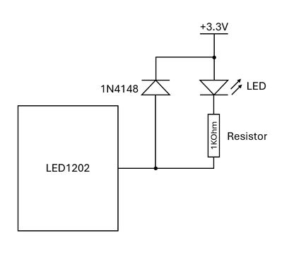

Could you please confirm whether below connections are same what you are talking about?

Right, but the diodes to vcc have to be at the driver and it's vcc to stop any spike here going higher than vcc.
And you can use any fast diode for this, I used BAS 16H , because small package, SMD, cheap and high peak current.
And 1k is a bit high resistance, can only drive 3 or 4 mA to the LED.
That's why I recommended 330 ohms, so just select a resistance that will allow the current you need for your LED, in the range of 270....1k .

Driver IC supply and LED supply is common +3.3V
2025-06-06 12:00 AM - edited 2025-06-06 12:00 AM
Yes, but you want prevent spike at driver, so diode has to be physically there and to vcc at driver. Only this position will prevent spike at driver. If you put it physically at the LED, it's totally useless.

Ok understood. We will take care of the same in layout.
