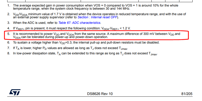

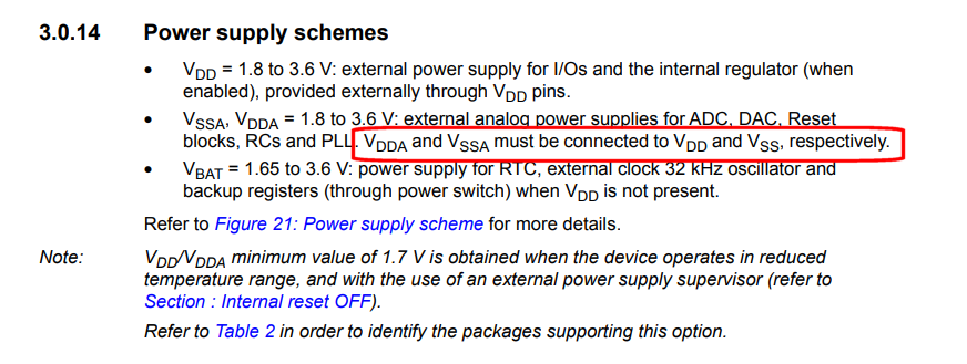

2025-03-18 5:12 AM
VDDA should be tied to VDD directly or through a ferrite bead.
2025-03-18 5:18 AM
Here it is connected to VCC through 330R resistor and a 3v zener to ground.

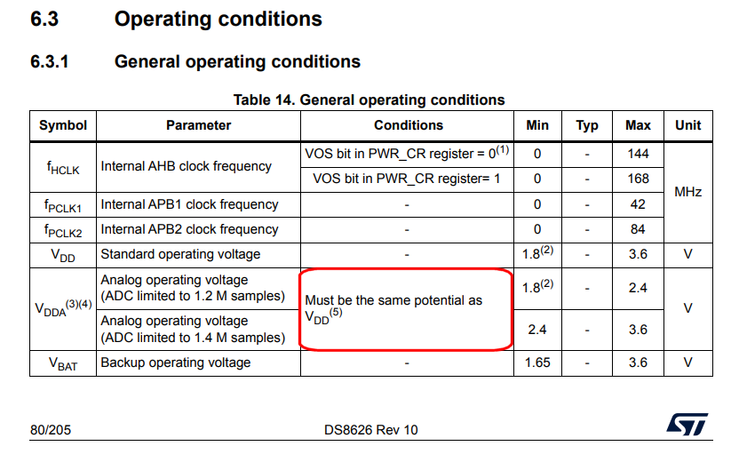

2025-03-18 5:42 AM
Why?
That's not what the datasheet tells you to do - they should be the same voltage:
2025-03-18 6:05 AM
I see that. That's why I pointed it out.
