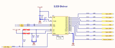

Can you show the circuit, so less guessing game?
2025-06-04 4:25 AM
Please find the below circuit.
2025-06-04 11:09 PM
Your circuit doesn't show the connection to the LED and what kind of LEDs used.
But from your findings with constant on driven LEDs: looks like the driver was overloaded, too high current or induction of a spike .
Which kind of LEDs, forward voltage?
And line/wire length from driver to GND return, = loop length: driver -- led-- gnd at driver?
I would at first increase the 100 resistors, maybe 330 ohms, to be sure, no over current can happen.

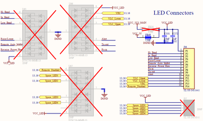

2025-06-05 6:14 AM
You can check the ESD diode implementation in below circuit. Grey color parts are ESD diodes (P/N# DT6250-06MR-13) on LED lines which were not mounted earlier. We have mounted these parts now on board but still are seeing failure issues.
Thank you
2025-06-05 9:12 AM
Grey...ok.
So they are useless here. Breakdown at 8 V, useless to protect 5v max chip.
So just try 1n4148 or similar, as freewheeling diodes to 3v3, on all lines to LEDs, at the driver chip.
