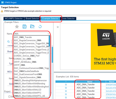

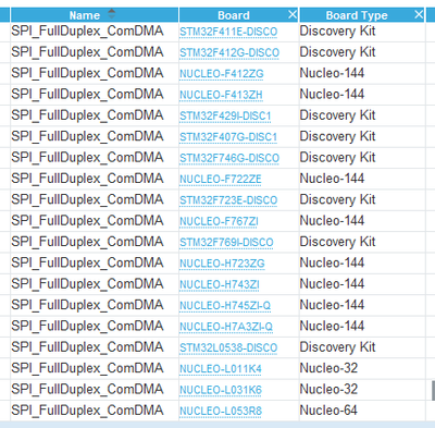

2025-01-23 6:04 PM - edited 2025-01-23 6:19 PM
The 3rd link in my previous post relates specifically to embedded systems.
The ST Cube Firmware Packs all contain DMA examples where supported.
@carlosdelfino wrote:say with a pooled system.
Not sure what you mean by that?
PS:
Also:
