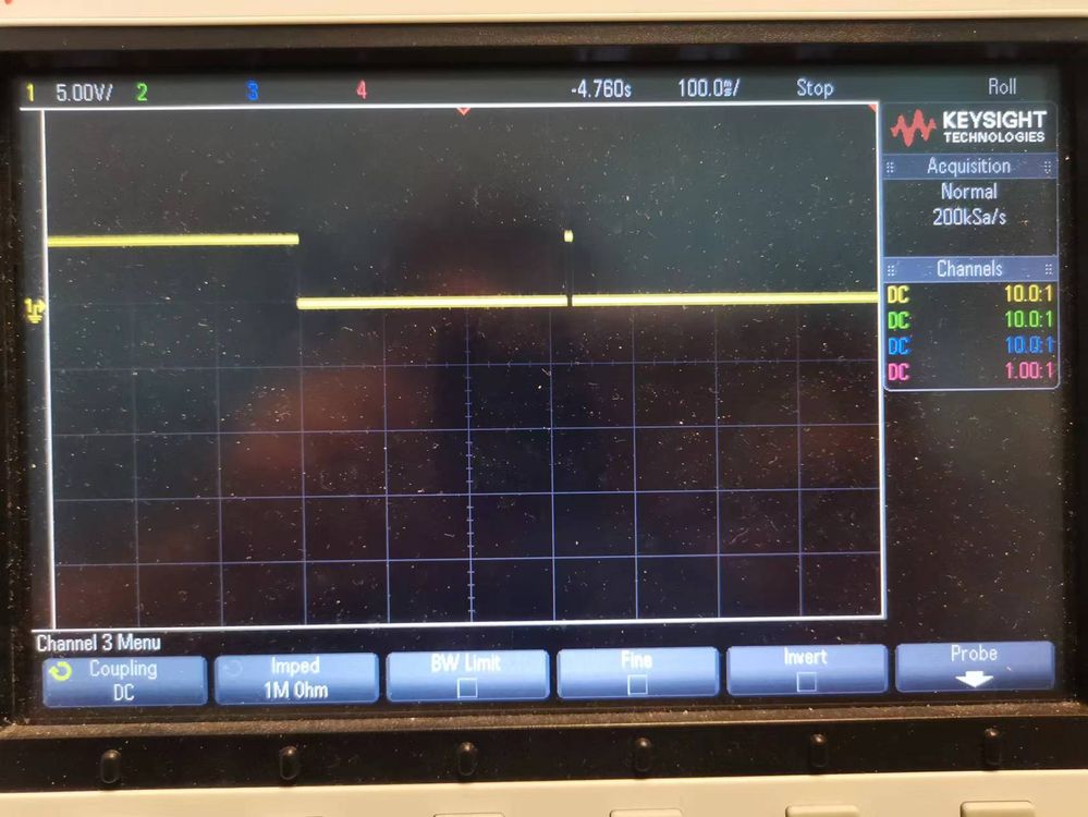

I made one bootloader then jumps to the application code, I set one GPIO pin as low before jump instruction then set GPIO pin as high at the beginning of the application code.
1, However, it takes so long time when measured by oscilloscope about 325ms.
and the bootloader runs well, I suspect what does the MCU do during that time why it takes some time?
