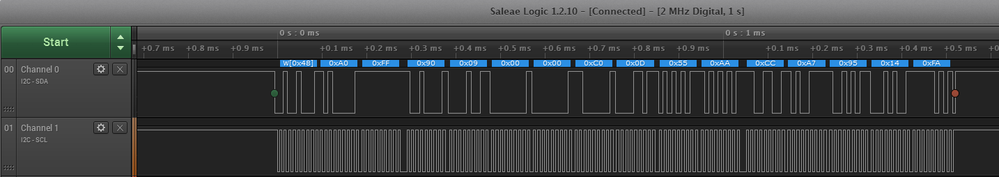

INTERRUPT_HANDLER(I2C_IRQHandler, 19)and busy flag is always set. Using an external device (verified to be working), I generate an I2C signal (100KHz) to communicate with STM8S005C6 program as a slave receiver with the 7-bit address of 0x24.

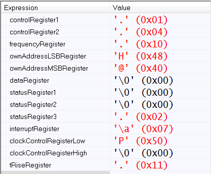

I have read out all the I2C registers to ensure all registers are properly configured.
For hardware side, SCL and SDA line is pulled up to 5v (verified with an oscilloscope).

Yes, I did enable the I2C peripheral. The register I2C_CR1 (Control Register 1) bit 0 has been set to 1.
