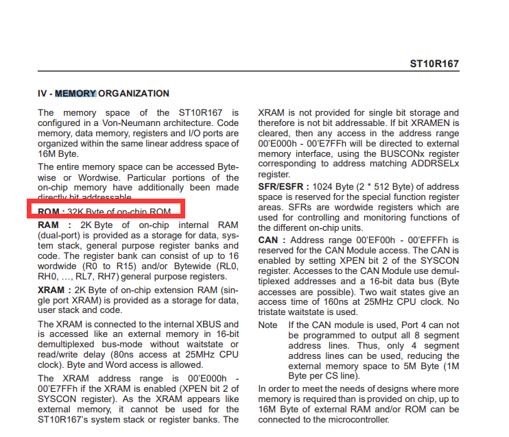

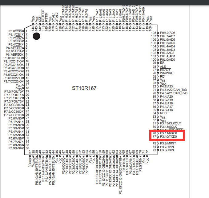

2023-05-02 9:20 AM - edited 2023-11-20 8:42 AM
st10r167 has 32kB internal ROMIt can be programed by TXD and RXD, st10 flasher tools
