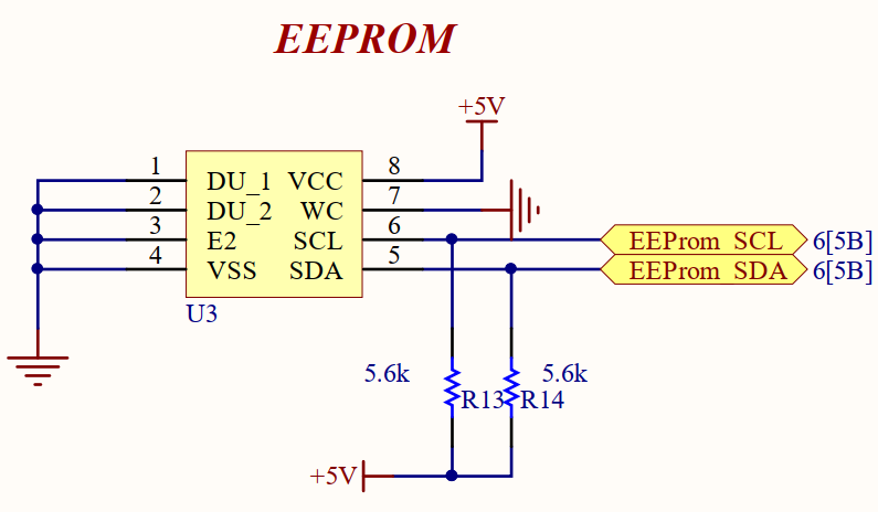

I am using STM32F4-Discovery. I want to R/W M24M02 E2prom but not reading device address. Added code and datasheet. I tried AT24C256 E2prom other I2C devices by same code and it worked.
Thanks.

2020-08-13 8:40 PM
may be hardware issue
2020-08-14 1:52 AM
Yes problem from HW. We had 3 m24m02 but 2 piece is broken.
Thank you.
