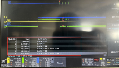

Figure 1: D data decode

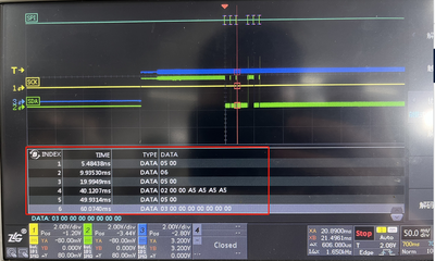

Figure 2: Q data decode
Yellow: clock
Green: D
Blue:Q
I have check the chip select PIN before, it's keep low level during send the instruction, it not shows in the scopes.
