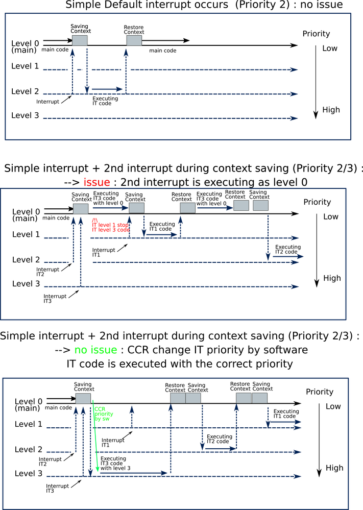

In document said: 'If an interrupt is cleared or masked when the context saving has already started'. What is it meant? And further. How to can prevent nested interruption from pending by software command? New interruption process may begin before first command in the handler.

Here a figure to help you to better understand. It is important to update by software the CCR register. You can have a look to the errata sheet.

Thank You very match for explanation charts. However, nowhere is it specified how many commands of the interrupt handler code will be guaranteed executed after the jump and before the nested interruption process? It is principal.
