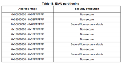

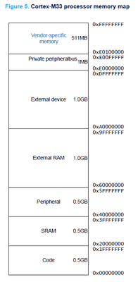

regarding the 4 possible address ranges to access same memories, this is due to the Cortex-M33 address space split between Code and SRAM and secure/non-secure split done with IDAU.
This allows full flexibility for your secure/non-secure code+data applications in a single set of contiguous memories (need to play with different load and execution address in linker).

I don't understand how applications are detected "secure/non-secure". Is there something specific that needs to be done to make them run in one mode or the other?
What do you mean by "need to play with different load and execution address in linker" ?
