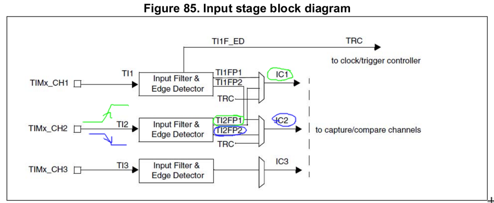

So, I don't know your setup, but you say you want to use TIM2_CH2 input pin. You could setup TIM2 the following way:
(The image above is from RM0016)
Set inputs for channels 1 & 2:
TIM2_CCMR1 = 0x22 (N=4 samples filter, input for CH1=TI2FP1)
TIM2_CCMR2 = 0x21 (N=4 samples filter, input for CH2=TI2FP2)
now you need to set the active edge and enable capture:
TIM2_CCER1 = 0x31 (rising edge for CH1 and falling edge for CH2).
You still need to enable the capture interrupts and maybe also the update interrupt to keep track of time.
Every edge will capture TIM2 value, and then you have enough time to read the captured value. Simple math, by subtracting the time between 2 edges will give you the captured signal.
Good luck!
