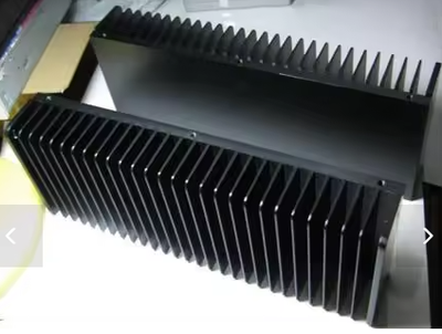

Just from my time, building power amps : for a average loss of 30W you need a big heat sink,
i used some like 300 x 80 x 40mm size ....to keep the amp under 40° . (2 x 100W amp)

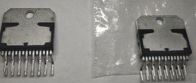

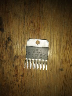

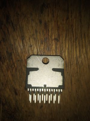

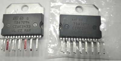

This question is for directly to ST that I had measured tda7294 and I got 5.59grams a ic in weight, a original tda7294 how much weight? Is this correct? I want answer from St stuffs who knows all about of this ic. Tell me is this weight correct? And I got two ic and print is different code and different lazer one is very deep print another one is light print,as you can see the attached pic. Both purchased from different sellers and different places. Left code is CZAK5433 and Right side is CZPKD403 is both are original??
