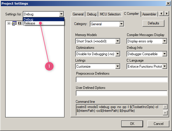

Hi
Is it reproduced for both Debug & Release project settings?
