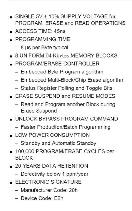

this is what datasheet reports, 20 years, actually my flash memory has been programmed in 1999, so i would like to know if with the re-programming of the device my flash will have data retention for other 20 years or it will lose data in few days.

You are currently talking about the M29F040B flash memory, which was spun off with the entire business unit in 2007 to the company Numonyx, which in turn was subsequently taken over by Micron, but Micron has also discontinued this ancient 5V technology.
Although there is no longer any documentation for these very old devices, it can be said that the 20-year data retention is a minimum value. With normal, not too strongly changing ambient temperatures, one can usually assume much longer periods for data retention - the flash does not suddenly forget its entire content after 20 years and one day.
Temperature cycles can cause the gate charge of the flash transistors that carry the bit information to decrease (you can think of this as a "drop" in the charge level). Reprogramming may be able to compensate for this effect. If you have the possibility of deleting the component and programming it again, you are welcome to do so. Of course, no one can give a guarantee for another 20 years.
