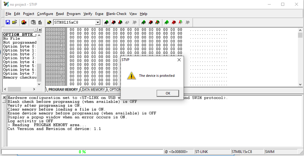

Hi experts!
Do you know what is my issue? and how can I solve it?
I'm using the ST-link v2 with the STM8 part as you can see below.
Note: I'm sure of the MCU part number.
Thank you in advance!
Best regards,
Tania

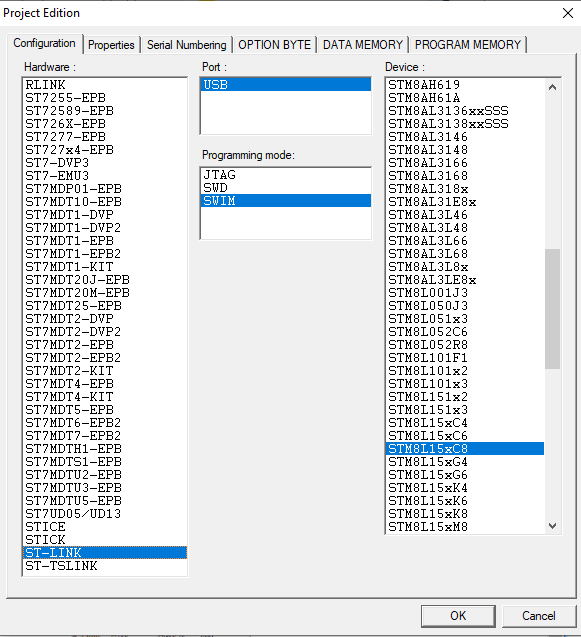

2023-04-28 7:56 AM
Maybe target MCU selection is wrong. Try select STM8L151x8. See more in UM0991 page 24.
If target MCU selection is ok, you need to remove option bytes readout protection.

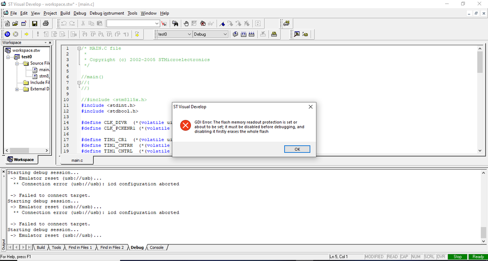

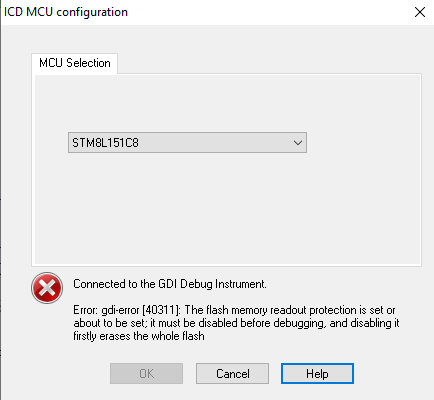

2023-04-28 9:08 AM - edited 2023-11-20 6:55 AM
When I tried with STVD programmer I got this.
Do you know what this issue is?
Thank you in advance.
Best regards,
Tania
2023-04-28 9:22 AM
It's either protected or not properly connecting..
Can you ERASE it to remove the protection?
Is this a device that has successfully been used before?
Any staff at your organization who have used these parts/tools previously?

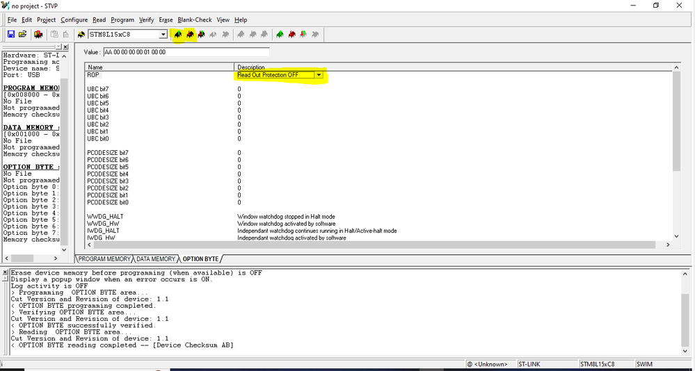

2023-04-28 10:30 AM - edited 2023-11-20 6:55 AM
Hi Tesla DeLorean,
Thank you for your prompt support. I'm using the MCU STM8L151C8.
I solved it with the following steps:
Best regards,
Tania
