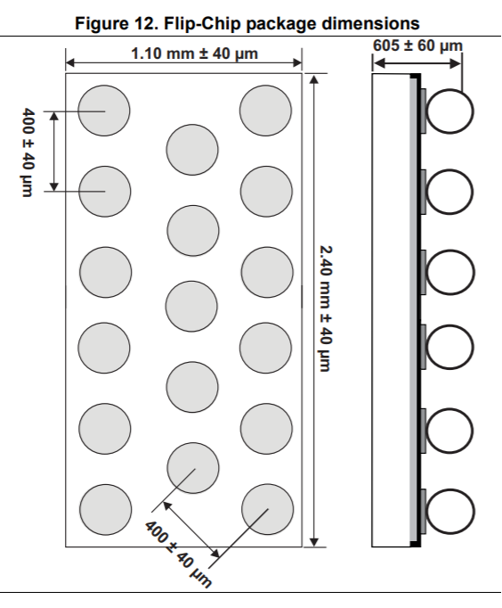

Hello Dave,
I confirm that EMIF06-HSD03F3 has bump pads that are all 0.4mm from each other as shown in figure 12 of its datasheet and reproduced below.
I hope this answers your question.

Thanks, do you think it would make sense to redraw the above figure then? The pads are clearly not all the same distance apart on the drawing - the middle column of pads is noticeably closer to the right than the left on both drawings in the datasheet - so it is a bit confusing.
Cheers,
Dave

Just to make sure : Bump side = bottom side?
Thanks
Dori
2023-01-18 8:29 AM
Yes, bump side is bottom side.
