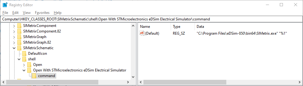

If that value in the registry is empty, maybe the eDSim installation has been done and completed with a different user respect to that one you are using now to lauch the .bat file. Could you verify?
2023-01-31 7:37 AM
2023-01-31 7:38 AM
Hi @EHD ,
you should see something like this in your registry:
With the reg key reporting something like this:
"C:\Program Files\eDSim-850\bin64\SIMetrix.exe" "%1"
Regards
