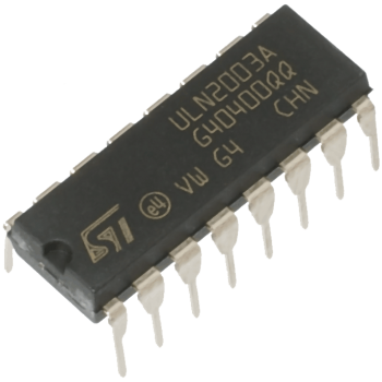

I have since found out the board it's from is obsolete. So knowing this chip or what to replace it with would be so much help

Yeah, really looking for specific context, like a make, model, or PCB number, something to key off of.
Searching 2003A DIP16 got this
https://www.soselectronic.com/products/stmicroelectronics/uln-2003-a-17748

I found this one and wondered as the number looks like a match
whats left of the numbers on the original.

wonder why this has GK5060LS?
2019-09-07 11:09 AM
Your photograph is pretty poor, but the digits look to be 2003A, and the ULN also works. Try something with higher resolution, is sharp and in focus.
You're looking at production, batch and test codes, not sure that's going to yield helpful results.
Pull a datasheet, review the PCB traces, and check if those are consistent.

Just got back after dropping in the ULN2003A and everything is working.
