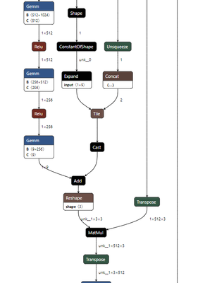

For the pointnet.onnx, X-cube-AI does not like undefined channel size, which may cause the error. In your onnx, your input size is [nb_value_grasp,35,512]. Even when fixing the nb_value_grasps to 1, there are still layer with unknown size:
The code used to obtain the onnx in the screenshot:

it seems that it is the constantOfShape that is introducing the unknown shape. If you manage to solve it, it may work with cubeAI. Another solution is to modify the model to create the mask (if I a not mistaken, it is what the middle branch of the graph is doing) in the init instead of the foward (if your are using pytorch).
