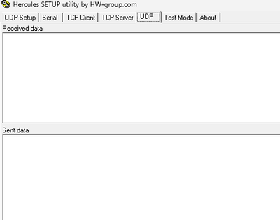

I am trying to communicate via ethernet on STm32f407 board with phy LAN8720. I have used TCP protocol and I have used Hercules for sending and reciving frame. But I want to acheive the operation sung HAL_ETH_Transmit (I want to send raw ethernet frame ).

2025-04-25 5:00 AM - edited 2025-04-25 5:35 AM
To my knowledge Wireshark is not intended to send ETH frames but to sniff and scan the network.
You can use Hercule to send and receive TCP or UDP packets.
2025-04-25 5:08 AM
Hi
Thank you will try the same .
B.R
Ash
