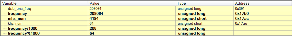

This is the first thing I thought, that the global variable was being modified somewhere (IE: by an interrupt), but this is not the case, look at the image below:mhz_num != 208
