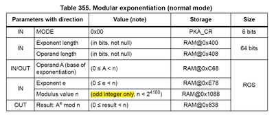

2024-11-08 9:52 AM - edited 2024-11-08 10:05 AM
Table from reference manual (page 1402).
What you have used is an even integer:
uint8_t mod[96] = {
LSB -> 0x00, 0x00, 0x00, 0x00, 0x00, 0x00, 0x00, 0x00, 0x00, 0x00, 0x00, 0x00, 0x00, 0x00, 0x00, 0x00,
0xff, 0xff, 0xff, 0xff, 0x00, 0x00, 0x00, 0x01, 0x00, 0x00, 0x00, 0x00, 0x00, 0x00, 0x00, 0x00,
0x00, 0x00, 0x00, 0x00, 0xff, 0xff, 0xff, 0xff, 0xff, 0xff, 0xff, 0xff, 0xff, 0xff, 0xff, 0xff
modulus = 0x00000000000000000000000000000000000000000000000000000000000000000000000000000000000000000000000000000000000000000000000000000000ffffffff00000001000000000000000000000000ffffffffffffffffffffffff <- LSB
I think you made a mistake when copying the Hex strings to the c-array. In the hex string the MSB is on the Left, but in the c-array definition, the MSB is on the right, so you should flip the arrays.
The second case should also not work correctly because the data that you have entered has a larger value than the modulus which is out-of-spec according to the table.
