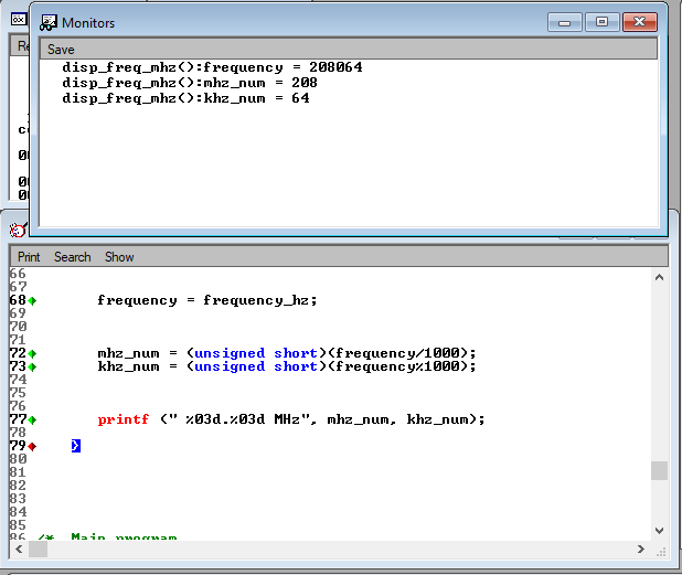

I'm developing an application (PROJECT) for a STM8S208RB (128k flash) t
hat was using around 100kB of flash and I
have added recently a new library (LIBRARY) that has increased memory usage up yo 120kBof flash
.I had an issue because of this event that has been solved. More info in here:
https://community.st.com/message/188751
In the new library I have a function that reads a frequency in Hz (
IE: 208064
) andthen print it in MHz (IE: 208.064 Hz):
void disp_freq_mhz(void)
{ uint32_t frequency; uint16_t mhz_num, khz_num;frequency = frequency_hz; // frequency_hz
is a global variable (uint32_t)
mhz_num = (uint16_t)(frequency/1000);
khz_num = (uint16_t)(frequency%1000);printf (' %03d.%03d MHz', mhz_num, khz_num);
The problem is sometimes
the division and/or modulus operations returns an erroneous value.
I have been debugging this error with STVD in the following way:
khz_num = (uint16_t)(frequency%1000);if(khz_num != 64 || mhz
_num != 208
) return;This is one reading of the variables involved in the function during one stop (the erroneous values are not always the same):
frequency_hz = 208064
frequency = 208064
mhz_num = 208
khz_num = 872 // sometimes it is 640, but most of the time the erroneous value is 872
Result of printf -> ' 208.872 MHz '
Has anybody any idea of why is failing this arithmetic operations?
Thanks all of you in advance,
Guillermo,
#uint16_t #uint32_t #basic-arithmeticSolved! Go to Solution.

I have built and simulated your example and I get the expected values
If your application fails ''sometimes'' (meaning that doing exactly the same sequence of commands you get sometimes one result, sometimes another), the problem is probably due to some runtime issue, like stack overflow or interrupts corrupting something.

The OP's issue is with the COSMIC STM8 compiler
I'd be suspicious of the code generation, and stack/heap/static corruption.
In the first case some static inspection of the code would provide some insight.
If the code looks to be inherently correct it could be separated out and run independently of the surrounding code/application.
I'd printf('%ld %ld\n', frequency, frequency_hz); in the error case to confirm the input conditions, especially for the potential of the global variable being modified.
