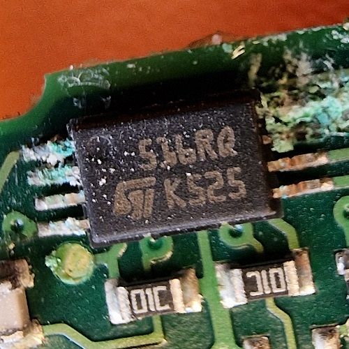

  • Hi, I am trying to get more info on what I believe is EEPROM chip, it is in Haldex 5th generation and trying to find same or similar replacement, as I have more and more faulty, corroded units that I could repair.
  • Any help welcome, Thanks all

516RQ - Marked ID - M95160-R ?
K525 <- Mfg
https://www.st.com/en/memories/m95160-r.html
M95160-DRDW3TP/K   VCC = 1.7 to 5.5 V    TSSOP8 (169 mils width)

Thank you very much for info, I still wonder if I'll be able to read data from old damaged one🤷‍:male_sign:
Hard to say, get some flux, sweat it off, and socket/fixture it or solder it onto any smt breakout board.
Other than that, find a working donor board or someone who's captured one previously.
I'll see how it goes, it contains vin/coding etc....I will try to read it and if not, I'll get working one and read it from there, then modify, thanks and take care
