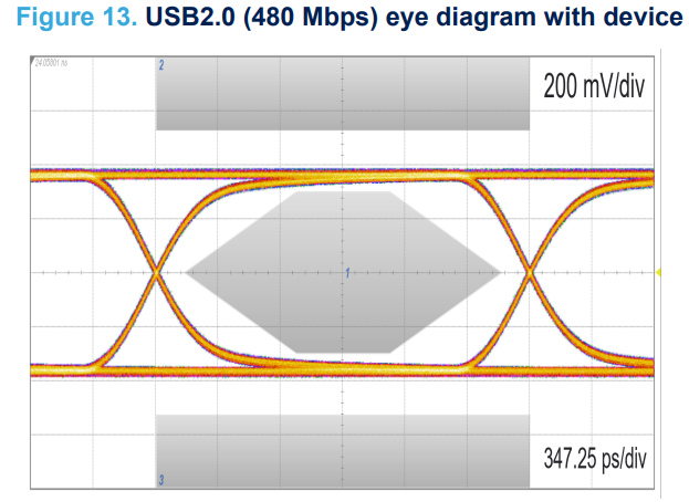

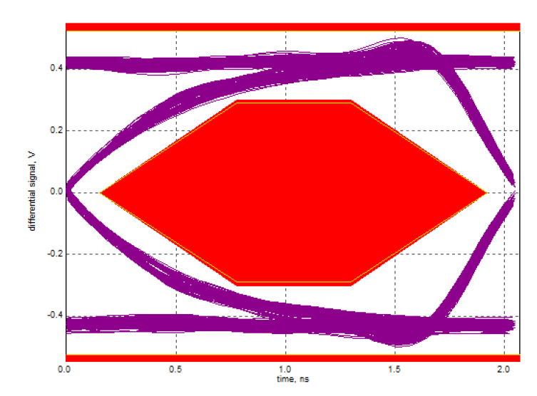

we are using the ECMF02-2AMX6 in our USB 2.0 lanes. The traces on our board are quite short. However, the measured eye diagram of USB 2.0 was not good. The eye is very close to the limit especially at the rising part. Now I saw that in the datasheet of the ECMF02-2AMX6 the eye diagram looks quite similar to ours. Would you confirm that the filter is likely the cause?If yes, are there any recommendations how to avoid this or get better signal integrity? Any filter type that has better signal integrity?

You’re right, the eye diagram you measured is close to the one on the ECMF02-2AMX6 datasheet : it is compliant with USB 2.0 requirements eye diagram template.
However, if you want more margin on eye diagram, I suggest you to use ECMF02-2HSMX6: below datasheet eye diagram for USB 2.0.
