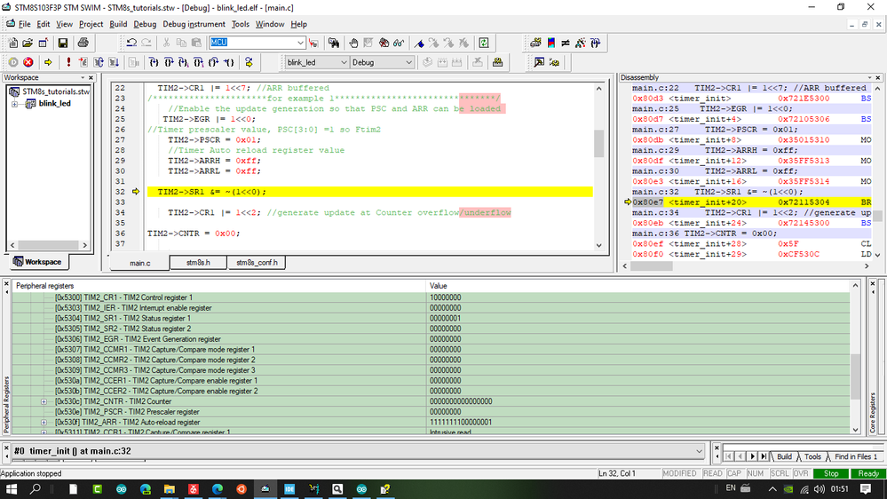

I am trying to generate a delay in STM8s103 using Timer peripheral TIM2.
but on equating the values to the Prescaler register(PSCR) and ARR. that is not happening
like I debugged my code step by step and on seeing the values of TIM2 registers, they are not loaded with assigned values. below is oic for it.
I am running my MCU at 2MHZ HSI and then using the PSC value for TIM2 be 1 so that my TImer frequency is 1MHZ and then generating delay of us, ms, and sec by using these functions
