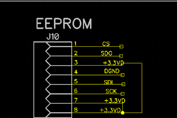

as per your suggestion I have made the changes in code. first, I am trying to only read status register in order to just ensure communication between memory and msp432 . thereafter I will try to write data in memory.
Steps to read status register:-
1) spi intialise :- spi is operate in 3 bit mode(no cs pin) with mode 0. ckpl bit set to 0 and ckph bit set to 1.
2) cs pin low
3) send 0x05
4) send dummy byte 0x00
5) read data of ststus register
6) cs pin high
but i got 0x00 in receive buffer.
I have attached code for your reference also i have attached screenshot of circuit diagram
2019-11-14 6:18 AM
As I read Data Sheet Sec 7.2, 0x00 is a not-incorrect SR value (albeit not a very distinctive one). Maybe try sending a WREN sequence first, then see if WEL=1?
In the just-to-make-sure department:
1) Add this line just before the "P3->DIR = BIT4" line, to make sure the device sees a falling edge [Ref DS Sec 7.1]:
> P3->OUT |= BIT4; // Initially high to ensure /CS falling edge
2) Check (one more time) to assure SDO is connected to SOMI and SDI to SIMO.
